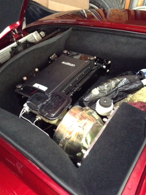

Mine is a useful mount for my amplifier in the front trunk. And I have enough room left over for a few cleaning supplies and car duster. :-) Luggage goes on the girlfriend's lap doesn't it? But seriously, the kit does come with stiffeners underneath as well so when all 4 are combined doesn't that help in the overall stiffness? Thanks, Ed

If one actually was an engineer and analyzed this brace, it is utterly useless. It braces the shear wall construction already built into the upper A-Arm mounting points. Not much movement here with the factory job. Lots of help is needed down below to take the twist out of the lower A-Arm supports. Larry

I could start by saying leave it i the corner of the garage, unless you are building and out and out racer.... it is only purpose in a street car is to further limit your wife's luggage allowance, although maybe that could be deemed a positive if she is then limited to only taking briefs and bras...
Others seem to have managed to bolt it in, sitting very low in the trunk (less than an inch between brace and trunk floor). To be functional it should sit directly behind the upper shock mounts. Julian __________________________________________________________________

I am currently working on the front trunk area and I am trying to figure out the best way to mount the triangular upper brace (the part sold by Precision ProFormance). The mounting plates have four bolt holes but it looks like I would not be able to get bolts to work as they would conflict with the upper suspension mounting rail. I am thinking the best solution may be to plug weld those holes from the trunk side. Can anyone share their experience installing these plates?
