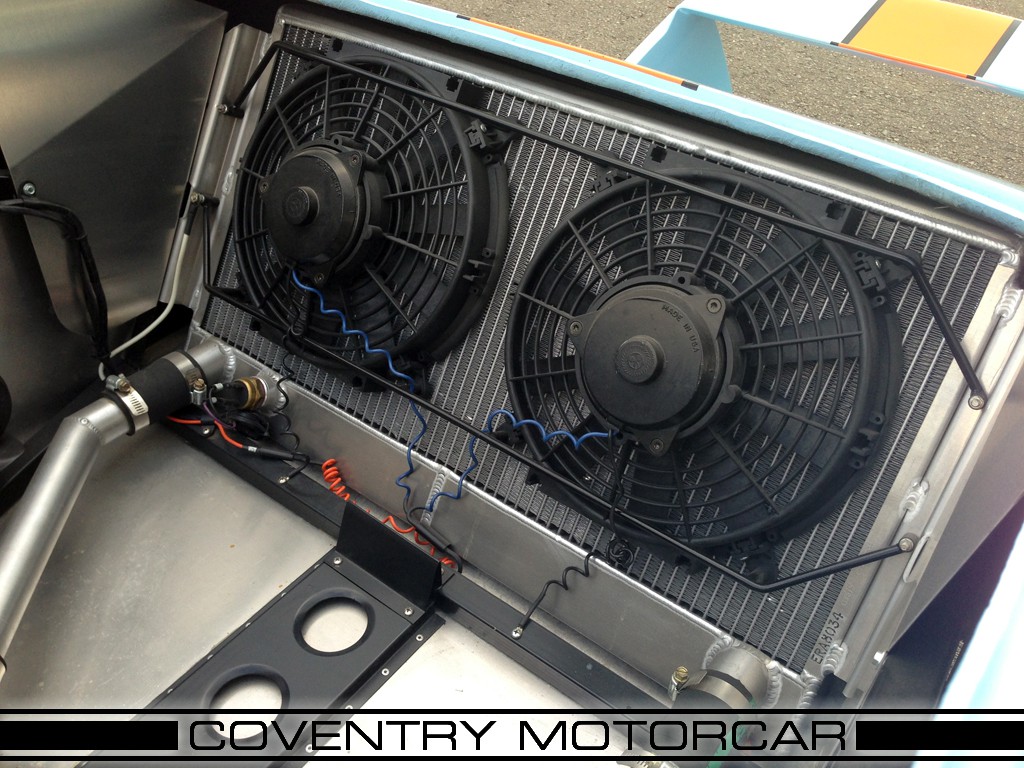

Charlie, I put a few miles on the GT40 during Hot August Nights and it is fine once moving at speed but getting hot in slow traffic. I also need to add A/C to it as it is akin to driving around in a sauna in the NV summer heat. The only real estate for the A/C condenser is up front so I expect that to further impact engine cooling. It would be quite easy to add an inline booster pump in the front behind the radiator. I did similar with my prior GT40, although that was converted to purely an electric pump (Meziere) and I eliminated the mechanical, so wondered about the dual setup. David Nunn sealed it for me when he said that the Stewart Warner is flow through design, that's exactly what I need and it seems others have managed or reduced cooling temps with a booster setup. Julian ________________________________ From: Charles McCall <charlesmccall@gmail.com> Sent: Wednesday, August 10, 2016 5:42 AM To: Julian Kift Cc: detomaso@server.detomasolist.com Subject: Re: [DeTomaso] Booster coolant pump Julian To answer your question, no I haven't. But curious if this is an exercise in re-engineering for its own sake, or what the problem is? On Tue, Aug 9, 2016 at 5:04 PM, Julian Kift <julian_kift@hotmail.com<mailto:julian_kift@hotmail.com>> wrote: Anyone used an electric booster pump in conjunction with the mechanical pump for improved cooling, if so what have you used and how is it configured (always on, pwm controller)? Thanks, Julian _______________________________________________ Detomaso Email List is not managed by POCA Posted emails must not exceed 1.5 Megabytes DeTomaso mailing list DeTomaso@server.detomasolist.com<mailto:DeTomaso@server.detomasolist.com> http://server.detomasolist.com/mailman/listinfo/detomaso To manage your subscription (change email address, unsubscribe, etc.) use the links above. Members who post to this list grant license to the list to forward any message posted here to all past, current, or future members of the list. They also grant the list owner permission to maintain an archive or approve the archiving of list messages. Charlie, I put a few miles on the GT40 during Hot August Nights and it is fine once moving at speed but getting hot in slow traffic. I also need to add A/C to it as it is akin to driving around in a sauna in the NV summer heat. The only real estate for the A/C condenser is up front so I expect that to further impact engine cooling. It would be quite easy to add an inline booster pump in the front behind the radiator. I did similar with my prior GT40, although that was converted to purely an electric pump (Meziere) and I eliminated the mechanical, so wondered about the dual setup. David Nunn sealed it for me when he said that the Stewart Warner is flow through design, that's exactly what I need and it seems others have managed or reduced cooling temps with a booster setup. Julian __________________________________________________________________ From: Charles McCall <charlesmccall@gmail.com> Sent: Wednesday, August 10, 2016 5:42 AM To: Julian Kift Cc: detomaso@server.detomasolist.com Subject: Re: [DeTomaso] Booster coolant pump Julian To answer your question, no I haven't. But curious if this is an exercise in re-engineering for its own sake, or what the problem is? On Tue, Aug 9, 2016 at 5:04 PM, Julian Kift <[1]julian_kift@hotmail.com> wrote: Anyone used an electric booster pump in conjunction with the mechanical pump for improved cooling, if so what have you used and how is it configured (always on, pwm controller)? Thanks, Julian _______________________________________________ Detomaso Email List is not managed by POCA Posted emails must not exceed 1.5 Megabytes DeTomaso mailing list [2]DeTomaso@server.detomasolist.com [3]http://server.detomasolist.com/mailman/listinfo/detomaso To manage your subscription (change email address, unsubscribe, etc.) use the links above. Members who post to this list grant license to the list to forward any message posted here to all past, current, or future members of the list. They also grant the list owner permission to maintain an archive or approve the archiving of list messages. References 1. mailto:julian_kift@hotmail.com 2. mailto:DeTomaso@server.detomasolist.com 3. http://server.detomasolist.com/mailman/listinfo/detomaso
