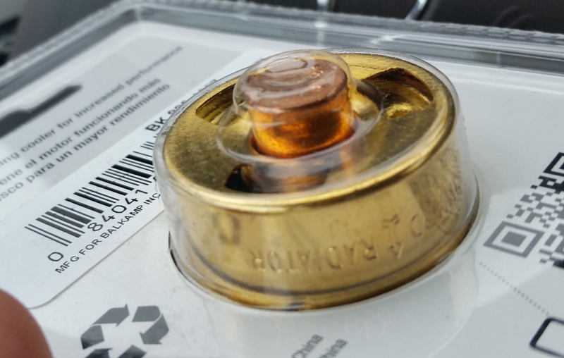

Here is a photo of the Marlin Jack's thermostat and restrictor. Notice the copper "hat" on the end. Also is a write up I did to compare the bypassing versus radiator flow between the proper thermostat and one that was sold by MS . A pic of the MS wrong stat in the packaging Joe in NC -----Original Message----- From: DeTomaso [mailto:detomaso-bounces@server.detomasolist.com] On Behalf Of Ed Lyerly Sent: Sunday, September 18, 2016 12:02 PM To: detomaso@server.detomasolist.com Subject: [DeTomaso] Thermostat .... visual differenced between Cleveland and. Windsor thermostats I have read several times of Pantera owners having overheating problems that were at least partially caused by using a Windsor thermostat in the Cleveland Pantera engine. Does anyone have a picture they could share which would allow a visual identification of the differences in these different thermostats? Thanks, --Ed L

-----Original Message----- From: Joseph F. Byrd, Jr. [mailto:byrdjf@embarqmail.com] Sent: Sunday, September 18, 2016 1:51 PM To: 'Ed Lyerly'; detomaso@server.detomasolist.com Subject: RE: [DeTomaso] Thermostat .... visual differenced between Cleveland and. Windsor thermostats

Ed, Yes, Long ago Matt Wells shared two photos; one a "Cleveland" thermostat and a Windsor. Find the photos here: www.provamo.com/Members/TechInfo/Cooling.asp Chuck (Running days behind - grin.) I have read several times of Pantera owners having overheating problems that were at least partially caused by using a Windsor thermostat in the Cleveland Pantera engine. Does anyone have a picture they could share which would allow a visual identification of the differences in these different thermostats? Thanks, --Ed L
Thank you Chuck ! Excellent reading and info :-) --Ed l -----Original Message----- From: The DeTomaso Registry Guy [mailto:detomasoregistry@gmail.com] Sent: Tuesday, September 20, 2016 7:38 PM To: 'Ed Lyerly'; detomaso@server.detomasolist.com Subject: RE: [DeTomaso] Thermostat .... visual differenced between Clevelandand. Windsor thermostats Ed, Yes, Long ago Matt Wells shared two photos; one a "Cleveland" thermostat and a Windsor. Find the photos here: www.provamo.com/Members/TechInfo/Cooling.asp Chuck (Running days behind - grin.) I have read several times of Pantera owners having overheating problems that were at least partially caused by using a Windsor thermostat in the Cleveland Pantera engine. Does anyone have a picture they could share which would allow a visual identification of the differences in these different thermostats? Thanks, --Ed L
