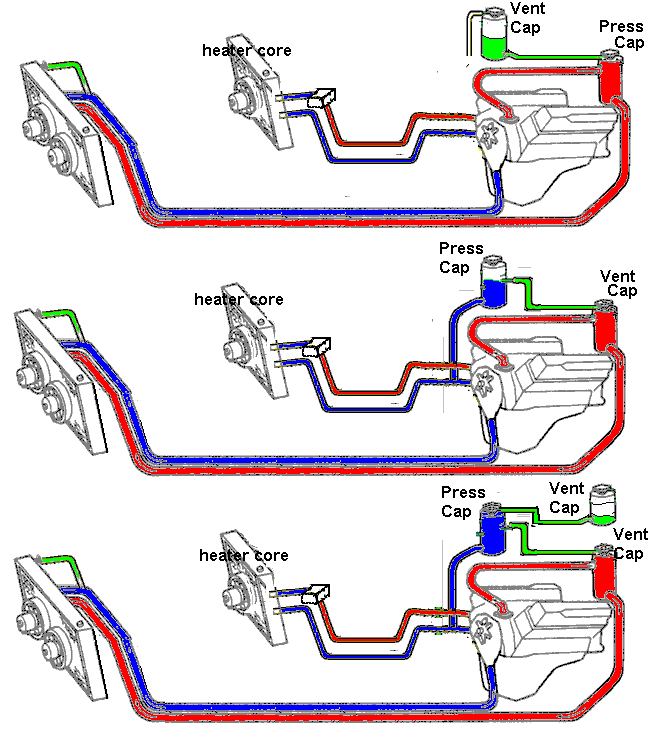

To me, having the pressure cap on the pump/block discharge side would be the "cause" for cavitation at the pump suction, with the increase resistance of the radiator the contributor. Replumbing the coolant to place the pressure cap on a true expansion tank on the pump suction seems to be desirable. Thus, keeping the pump suction at a constant, not decreasing pressure with increasing flow. Turbulence in the pump inlet "elbow" would also contribute to cavitation and using a vane in that elbow be beneficial. JFB -----Original Message----- From: DeTomaso [mailto:detomaso-bounces@server.detomasolist.com] On Behalf Of Ken Green via DeTomaso Sent: Tuesday, July 26, 2016 15:20 PM To: L GRAY; hoppe1@cox.net Cc: detomaso Subject: Re: [DeTomaso] Cooling system ...cause cavitation at high RPM in the water pump in a Pantera...
Joe, I think that what John describes here? http://www.spacecitypanteras.com/Technical/Pantera_Cooling-JTaphorn.pdf From: "Joseph F. Byrd, Jr." <byrdjf@embarqmail.com> To: detomaso@server.detomasolist.com Sent: Tuesday, July 26, 2016 1:00 PM Subject: Re: [DeTomaso] Cooling system To me, having the pressure cap on the pump/block discharge side would be the "cause" for cavitation at the pump suction, with the increase resistance of the radiator the contributor. Replumbing the coolant to place the pressure cap on a true expansion tank on the pump suction seems to be desirable. Thus, keeping the pump suction at a constant, not decreasing pressure with increasing flow. Turbulence in the pump inlet "elbow" would also contribute to cavitation and using a vane in that elbow be beneficial. JFB -----Original Message----- From: DeTomaso [mailto:detomaso-bounces@server.detomasolist.com] On Behalf Of Ken Green via DeTomaso Sent: Tuesday, July 26, 2016 15:20 PM To: L GRAY; hoppe1@cox.net Cc: detomaso Subject: Re: [DeTomaso] Cooling system ...cause cavitation at high RPM in the water pump in a Pantera... _______________________________________________ Detomaso Email List is not managed by POCA Posted emails must not exceed 1.5 Megabytes DeTomaso mailing list DeTomaso@server.detomasolist.com http://server.detomasolist.com/mailman/listinfo/detomaso To manage your subscription (change email address, unsubscribe, etc.) use the links above. Members who post to this list grant license to the list to forward any message posted here to all past, current, or future members of the list. They also grant the list owner permission to maintain an archive or approve the archiving of list messages. Joe, I think that what John describes here? [1]http://www.spacecitypanteras.com/Technical/Pantera_Cooling-JTaphorn. pdf __________________________________________________________________ From: "Joseph F. Byrd, Jr." <byrdjf@embarqmail.com> To: detomaso@server.detomasolist.com Sent: Tuesday, July 26, 2016 1:00 PM Subject: Re: [DeTomaso] Cooling system To me, having the pressure cap on the pump/block discharge side would be the "cause" for cavitation at the pump suction, with the increase resistance of the radiator the contributor. Replumbing the coolant to place the pressure cap on a true expansion tank on the pump suction seems to be desirable. Thus, keeping the pump suction at a constant, not decreasing pressure with increasing flow. Turbulence in the pump inlet "elbow" would also contribute to cavitation and using a vane in that elbow be beneficial. JFB -----Original Message----- From: DeTomaso [mailto:[2]detomaso-bounces@server.detomasolist.com] On Behalf Of Ken Green via DeTomaso Sent: Tuesday, July 26, 2016 15:20 PM To: L GRAY; [3]hoppe1@cox.net Cc: detomaso Subject: Re: [DeTomaso] Cooling system ...cause cavitation at high RPM in the water pump in a Pantera... _______________________________________________ Detomaso Email List is not managed by POCA Posted emails must not exceed 1.5 Megabytes DeTomaso mailing list [4]DeTomaso@server.detomasolist.com [5]http://server.detomasolist.com/mailman/listinfo/detomaso To manage your subscription (change email address, unsubscribe, etc.) use the links above. Members who post to this list grant license to the list to forward any message posted here to all past, current, or future members of the list. They also grant the list owner permission to maintain an archive or approve the archiving of list messages. References 1. http://www.spacecitypanteras.com/Technical/Pantera_Cooling-JTaphorn.pdf 2. mailto:detomaso-bounces@server.detomasolist.com 3. mailto:hoppe1@cox.net 4. mailto:DeTomaso@server.detomasolist.com 5. http://server.detomasolist.com/mailman/listinfo/detomaso
YES, but being just one of the many modifications John T made. I was think something that would not be noticeable and use the existing tanks. Attached description ; The top being the original where the pump suction decreases with increased flow. The center would have pump suction increasing with coolant temperature and The bottom would have pump suction constant (requires adding a recovery tank) Has anyone ever measured the dP/flow across their radiator? JFB From: Ken Green [mailto:kenn_green@yahoo.com] Sent: Tuesday, July 26, 2016 16:12 PM To: Joseph F. Byrd, Jr.; detomaso@server.detomasolist.com Subject: Re: [DeTomaso] Cooling system Joe, I think that what John describes here? http://www.spacecitypanteras.com/Technical/Pantera_Cooling-JTaphorn.pdf _____ From: "Joseph F. Byrd, Jr." <byrdjf@embarqmail.com> To: detomaso@server.detomasolist.com Sent: Tuesday, July 26, 2016 1:00 PM Subject: Re: [DeTomaso] Cooling system To me, having the pressure cap on the pump/block discharge side would be the "cause" for cavitation at the pump suction, with the increase resistance of the radiator the contributor. Replumbing the coolant to place the pressure cap on a true expansion tank on the pump suction seems to be desirable. Thus, keeping the pump suction at a constant, not decreasing pressure with increasing flow. Turbulence in the pump inlet "elbow" would also contribute to cavitation and using a vane in that elbow be beneficial. JFB -----Original Message----- From: DeTomaso [mailto:detomaso-bounces@server.detomasolist.com] On Behalf Of Ken Green via DeTomaso Sent: Tuesday, July 26, 2016 15:20 PM To: L GRAY; hoppe1@cox.net Cc: detomaso Subject: Re: [DeTomaso] Cooling system ...cause cavitation at high RPM in the water pump in a Pantera... _______________________________________________ Detomaso Email List is not managed by POCA Posted emails must not exceed 1.5 Megabytes DeTomaso mailing list DeTomaso@server.detomasolist.com http://server.detomasolist.com/mailman/listinfo/detomaso To manage your subscription (change email address, unsubscribe, etc.) use the links above. Members who post to this list grant license to the list to forward any message posted here to all past, current, or future members of the list. They also grant the list owner permission to maintain an archive or approve the archiving of list messages. YES, but being just one of the many modifications John T made. I was think something that would not be noticeable and use the existing tanks. Attached description ; The top being the original where the pump suction decreases with increased flow. The center would have pump suction increasing with coolant temperature and The bottom would have pump suction constant (requires adding a recovery tank) Has anyone ever measured the dP/flow across their radiator? JFB From: Ken Green [mailto:kenn_green@yahoo.com] Sent: Tuesday, July 26, 2016 16:12 PM To: Joseph F. Byrd, Jr.; detomaso@server.detomasolist.com Subject: Re: [DeTomaso] Cooling system Joe, I think that what John describes here? [1]http://www.spacecitypanteras.com/Technical/Pantera_Cooling-JTaphorn. pdf _______________________________________________________________________ From: "Joseph F. Byrd, Jr." <[2]byrdjf@embarqmail.com> To: [3]detomaso@server.detomasolist.com Sent: Tuesday, July 26, 2016 1:00 PM Subject: Re: [DeTomaso] Cooling system To me, having the pressure cap on the pump/block discharge side would be the "cause" for cavitation at the pump suction, with the increase resistance of the radiator the contributor. Replumbing the coolant to place the pressure cap on a true expansion tank on the pump suction seems to be desirable. Thus, keeping the pump suction at a constant, not decreasing pressure with increasing flow. Turbulence in the pump inlet "elbow" would also contribute to cavitation and using a vane in that elbow be beneficial. JFB -----Original Message----- From: DeTomaso [mailto:[4]detomaso-bounces@server.detomasolist.com] On Behalf Of Ken Green via DeTomaso Sent: Tuesday, July 26, 2016 15:20 PM To: L GRAY; [5]hoppe1@cox.net Cc: detomaso Subject: Re: [DeTomaso] Cooling system ...cause cavitation at high RPM in the water pump in a Pantera... _______________________________________________ Detomaso Email List is not managed by POCA Posted emails must not exceed 1.5 Megabytes DeTomaso mailing list [6]DeTomaso@server.detomasolist.com [7]http://server.detomasolist.com/mailman/listinfo/detomaso To manage your subscription (change email address, unsubscribe, etc.) use the links above. Members who post to this list grant license to the list to forward any message posted here to all past, current, or future members of the list. They also grant the list owner permission to maintain an archive or approve the archiving of list messages. References 1. http://www.spacecitypanteras.com/Technical/Pantera_Cooling-JTaphorn.pdf 2. mailto:byrdjf@embarqmail.com 3. mailto:detomaso@server.detomasolist.com 4. mailto:detomaso-bounces@server.detomasolist.com 5. mailto:hoppe1@cox.net 6. mailto:DeTomaso@server.detomasolist.com 7. http://server.detomasolist.com/mailman/listinfo/detomaso
