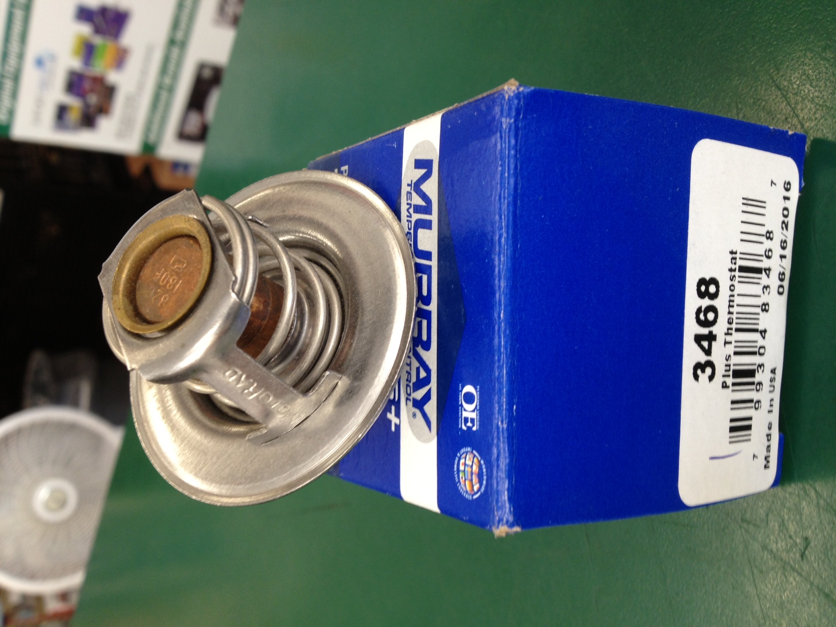

Here is the version O'Reilly sells.... Mike Sent from my iPhone On Sep 19, 2016, at 14:47, Mike Drew <MikeLDrew@aol.com> wrote:

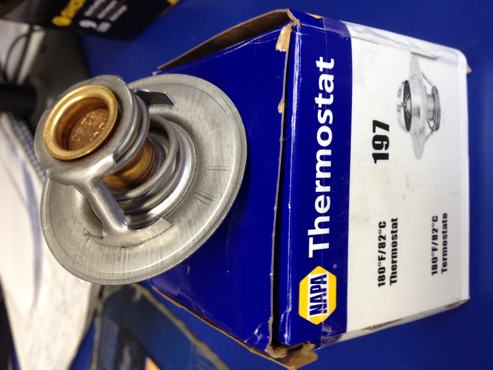

All,
Stephane Bergeron is visiting from Paris and we just picked up a thermostat from NAPA. Here is all you need to know...
<image.jpeg>

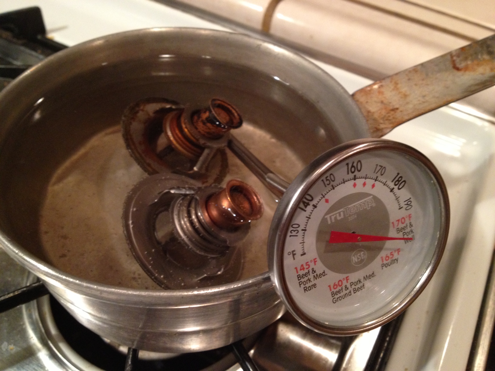

Here is an older photo comparing an original Ford thermostat with the NAPA 197. This is what they look like when they are open. The Ford unit is in all respects the same as the NAPA part. I don't know what makes the Robertshaw unit 'high flow' but I drank that Kool Aid and bought them when they were available.... Mike Sent from my iPhone On Sep 19, 2016, at 14:47, Mike Drew <MikeLDrew@aol.com> wrote:

A pic of the MS wrong stat in the packaging
Joe in NC
