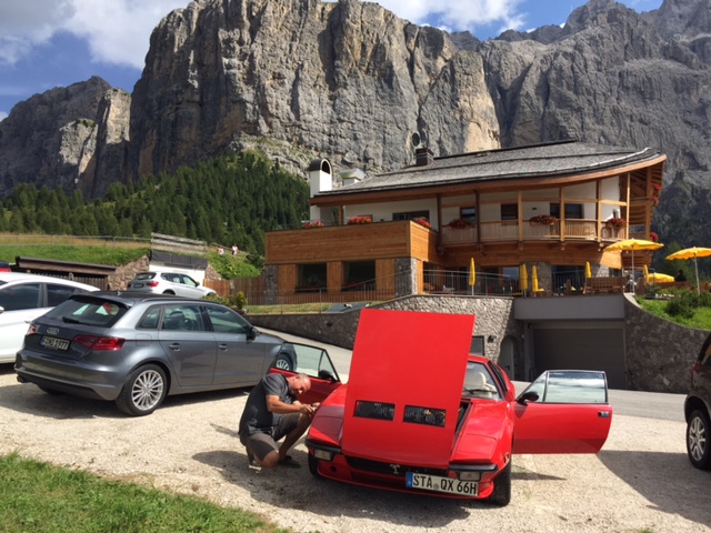

PS. A nice photo from recent drive over Dolomites...just trying to pull out front fender lip a bit :)
<IMG_3341.jpg> _______________________________________________
