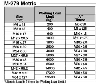

Okay...really dumb question here. Wouldn't hard braking want to loosen
A single six mm diameter screw itself is just about able to lift the weight of the car. Tomas <-----Ursprungligt Meddelande-----> From: Larry Weston [lplugw@hotmail.com] Sent: 20/5/2016 10:49:42 PM To: julian_kift@hotmail.com Cc: MikeLDrew@aol.com;detomaso@detomasolist.com Subject: Re: [DeTomaso] Which axles on which side? That being said, I have sometimes wondered about the faith we put in that 1/8" thick bearing retainer plate we secure with four six mm diameter flathead screws. That seems like a weak link. Best not to think about it to much I decided. Sent from my iPhone the axle nut??

Ok. Not sure about the physics of all of it, but if that's the case, there are four of them. Sent from my iPhone On May 21, 2016, at 5:14 PM, Tomas Gunnarsson <guson@home.se<mailto:guson@home.se>> wrote: A single six mm diameter screw itself is just about able to lift the weight of the car. Tomas <-----Ursprungligt Meddelande-----> From: Larry Weston [lplugw@hotmail.com<mailto:lplugw@hotmail.com>] Sent: 20/5/2016 10:49:42 PM To: julian_kift@hotmail.com<mailto:julian_kift@hotmail.com> Cc: MikeLDrew@aol.com<mailto:MikeLDrew@aol.com>;detomaso@detomasolist.com<mailto:detomaso@detomasolist.com> Subject: Re: [DeTomaso] Which axles on which side? That being said, I have sometimes wondered about the faith we put in that 1/8" thick bearing retainer plate we secure with four six mm diameter flathead screws. That seems like a weak link. Best not to think about it to much I decided. Sent from my iPhone

A good reference to use would be an eye bolt rating chart -----Original Message----- From: DeTomaso [mailto:detomaso-bounces@server.detomasolist.com] On Behalf Of Larry Weston Sent: Saturday, May 21, 2016 20:15 PM To: Tomas Gunnarsson Cc: detomaso@detomasolist.com Subject: Re: [DeTomaso] Which axles on which side? Ok. Not sure about the physics of all of it, but if that's the case, there are four of them. Sent from my iPhone On May 21, 2016, at 5:14 PM, Tomas Gunnarsson < <mailto:guson@home.se%3cmailto:guson@home.se> guson@home.se<mailto:guson@home.se>> wrote: A single six mm diameter screw itself is just about able to lift the weight of the car. Tomas <-----Ursprungligt Meddelande-----> From: Larry Weston [lplugw@hotmail.com< <mailto:lplugw@hotmail.com> mailto:lplugw@hotmail.com>] Sent: 20/5/2016 10:49:42 PM To: <mailto:julian_kift@hotmail.com%3cmailto:julian_kift@hotmail.com> julian_kift@hotmail.com<mailto:julian_kift@hotmail.com> Cc: <mailto:MikeLDrew@aol.com%3cmailto:MikeLDrew@aol.com%3e;detomaso@detomasolis t.com%3cmailto:detomaso@detomasolist.com> MikeLDrew@aol.com<mailto:MikeLDrew@aol.com>;detomaso@detomasolist.com<mailto :detomaso@detomasolist.com> Subject: Re: [DeTomaso] Which axles on which side? That being said, I have sometimes wondered about the faith we put in that 1/8" thick bearing retainer plate we secure with four six mm diameter flathead screws. That seems like a weak link. Best not to think about it to much I decided. Sent from my iPhone
