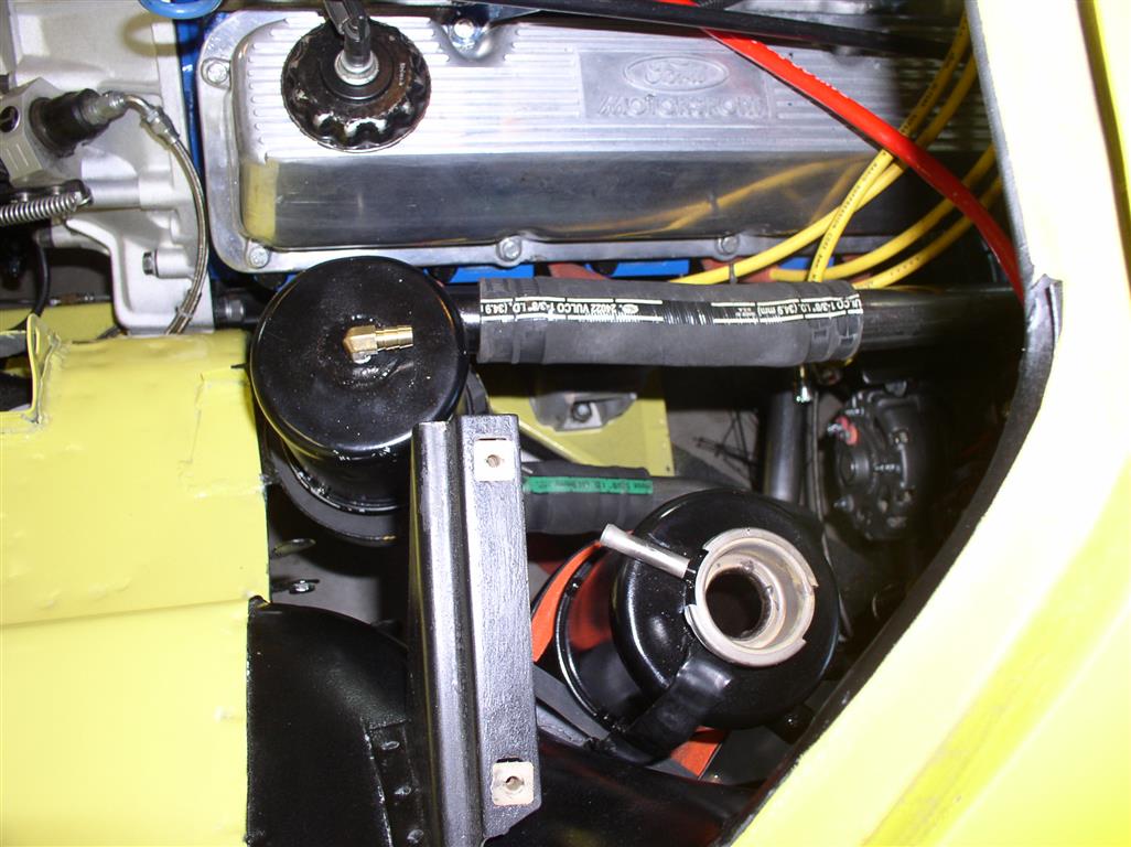

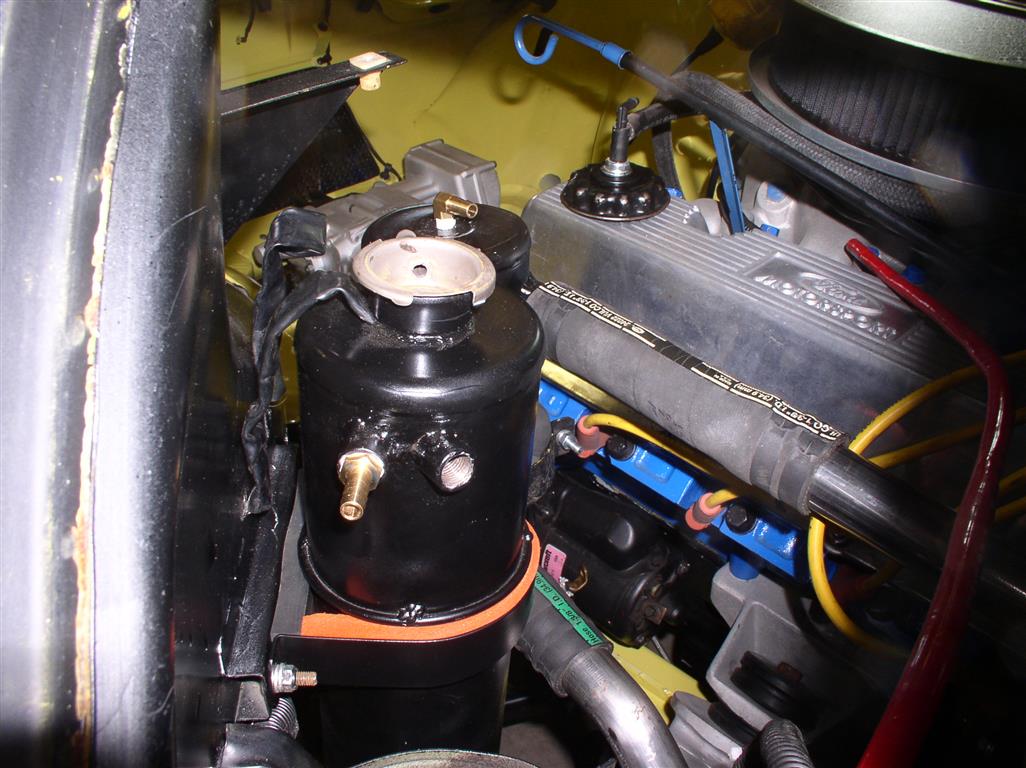

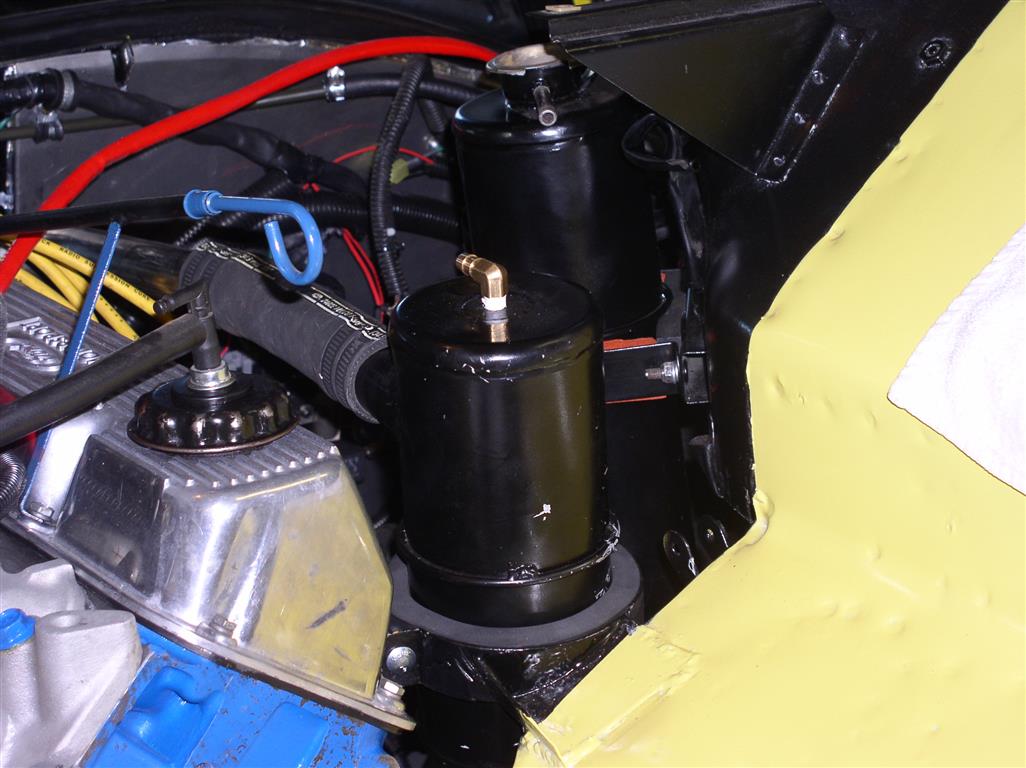

Here's the other shots of my tanks.
These mods were fabricated up by W-Wadeco Inc. (Wade Musil of Tucson, AZ)
#8 shows the brass elbow on the top of the swirl tank. The pressure cap was removed and the top sealed up. Actually, Wade built me a complete new swirl tank.
#9 shows the two "inlet fittings" on the top of the expansion tank. Wade fabricated this entire tank as well.
#10 shows the mounting in the bay. The plumbing is not hooked up in this picture.

This (below) is a genius modification, creating a true active deaeration system using suction from the water pump to continuously flow water through the expansion tank, drawing air from the high points in the system. But how common, how many have built a system like this ? The TSB modification, which some here ( Tomas? ) have confirmed was likely incorporated at the factory, connects the relatively high-pressure swirl tank to the lower-pressure radiator, so I conclude while the engine is running, nothing is going to flow from the radiator to the swirl tank, it's not going to actively de-aerate. Initial fill, I can see it helping. After that, I'm scratching my head. Thanks, GD

There is definitely a mod that sucks air from both the swirl tank, and the top of the radiator into the expansion tank. The expansion tank is under suction, and this causes any trapped air to bleed to the expansion tank.
I did this on my car.
I believe that it does its job, especially of removing any trapped air from the radiator.
I had to run a new, separate metal hard line down the length of the car from near the front of the radiator, all the way back up the bulkhead past the electrics panel, to near the expansion tank.
Here are pictures of my tanks with the appropriate bleed fittings installed.
Chuck
